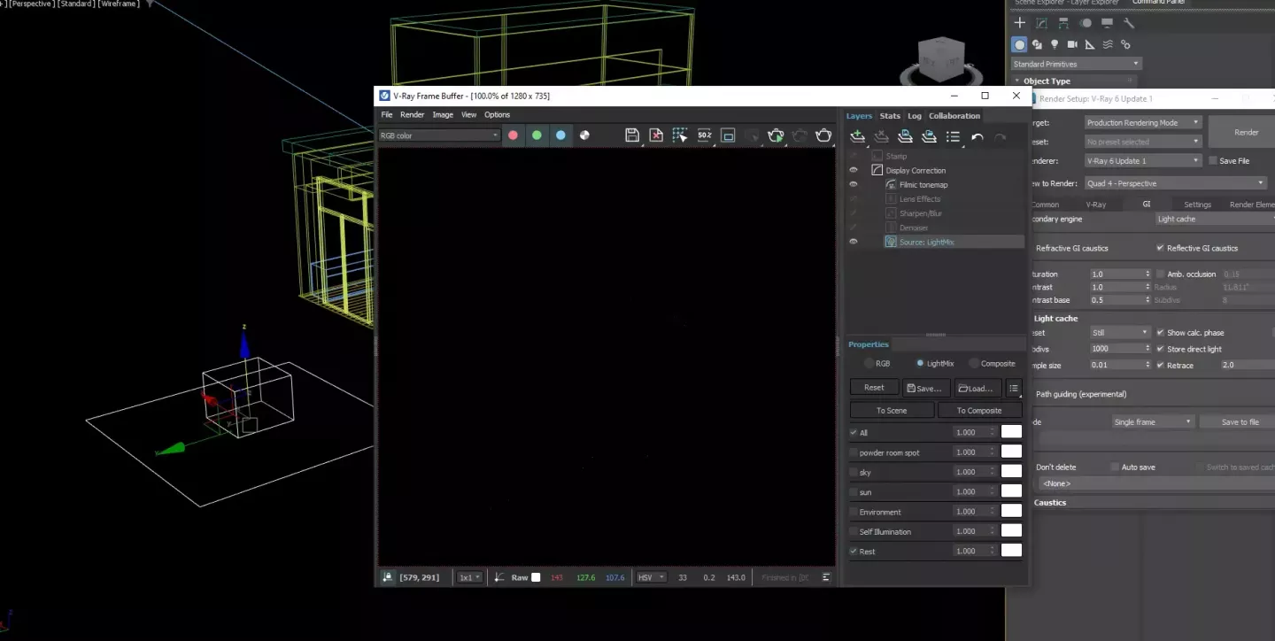

    It seems that LightMix doesn't work properly with the "Amb. occlusion" feature in GI. Please see the screenshots below. Notice how the objects glow where the surfaces meet when lights are turned off in LightMix. This should not happen.

    Hmm, I can't seem to reproduce it on a fresh scene. Could you simplify yours and attach (or send) it?
      Sure. Simplified scene attached. I've already set it up for you. You just need to start IPR.

        Just so you know we've reproduced the issue. We'll have a discussion on how to handle it and write back.
