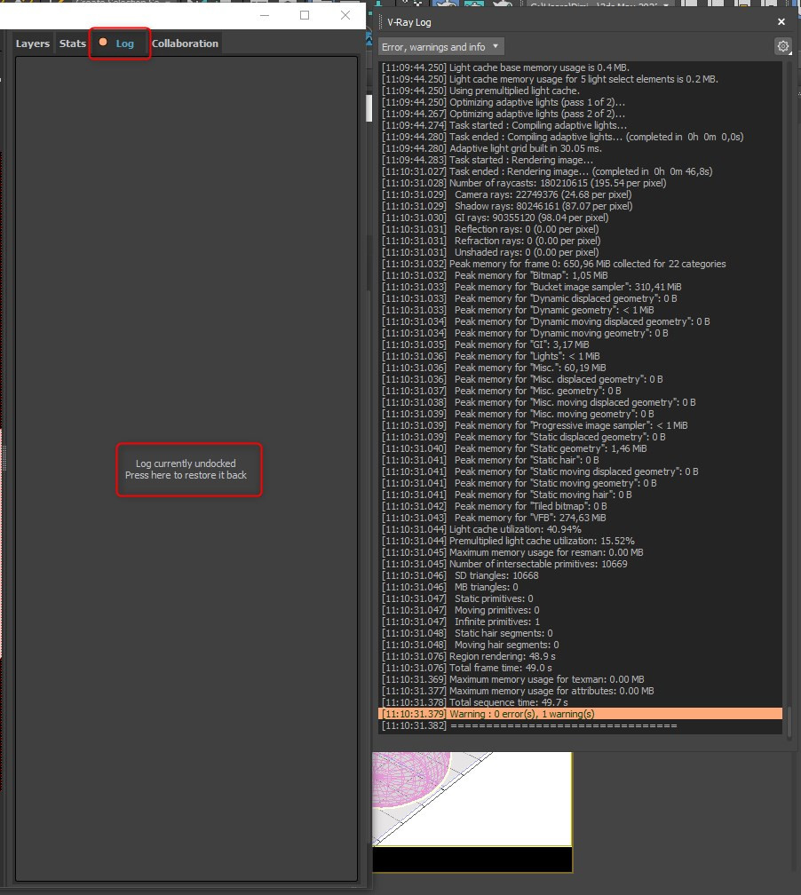

    Hi, probably your Log window is appearing as a floating window. You can dock it back by pressing the sign in the VFB. If you set it to "Never" in the V-Ray settings while the window is undocked and if you close it, it should not open again once a new render is started. However, it's recommended to have it at least in your VFB.
      yeah, i have had it undocking quite a few times, since getting latest..never ever had that issue before..seems a lot more sensitive.
        THX
        Will try.
        3ds Max 2016/2021 (Vray 6.x), Windows 10 64bit , AMD 2990WX ThreadRipper 32/64 Cores, 128 gigs RAM , 2X RTX3090 48GB RAM
          It works but when I start 3ds max or open another scene - it opens again floating - how can I set it so that it always stays in the VFB ? This issue is new with update 6.1.

            Is there an error showing when the render starts? If yes, can you make a screenshot? That would help us to understand why the Log window is showing separately.

                  Hi. Are there any errors shown in the Log window? If yes, can you make a screenshot of them?

                      The log verbosity and log policy are 2 different things :
                      1) The log verbosity is controlled directly in the log window and filters out messages with a level lower than what is selected.
                      It has nothing to do on how/when the log is created or shown.
                      Click image for larger version  Name:	image.png Views:	0 Size:	6.7 KB ID:	1175870
                      2) The log policy has always been in V-Ray for 3dsMax, under the Render Settings options - System (Advanced).
                      As stated in the tooltip, it determines the condition for showing the log.
                      Click image for larger version  Name:	image.png Views:	0 Size:	56.9 KB ID:	1175869
                      The log will be shown by itself only if the condition is met AND if the VFB is either not shown or not intended to be shown (ex: starting a new render with the VFB enabled).
                      Messages logged may not directly be caused within a rendering context, it may be due to something wrong we need to inform while doing anything.
                      You may even render without the VFB enabled, so again in this case we need the log to show when the policy condition is met.​
                      For example doing USD export which generates a warning for whatever reason will not open the VFB (and nobody wants that) so then the log will automatically be shown with the default policy.
                      You can disable it by setting the policy to Never if you don't want to see it within this scene.
                      The default being "Only on error/warning", indeed creating a new scene will automatically reset it as it is not a per-user persistent setting.
