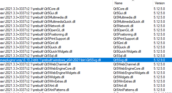

            What I find strange though (and could be why it crashes) is that Qt5Svg.dll is the only DLL that is being loaded from where V-Ray is installed. All other Qt DLLs are being loaded from the root 3ds Max folder. Attached photo is what is actively loaded by the 3dsmax.exe process with the highlighted line being in the V-Ray directory.
              In your case, Qt5Svg is loaded from the VFB package because that's the first dll the loader is able to load. I don't have all the details but initially as I said I would assume the Qt5Svg coming with 3dsmax package was somehow missing (deleted or whatever). Definitely it should be part of the 3dsmax qt package.
              The versing check within Qt does require the exact same version if I recall correctly. It won't even allow a minor version diff. And then again when this check fails, it raises a fatal error which basically force end the process so it appears as a crash (it is not coming from either V-Ray or from the VFB, this is directly enforced within Qt so we cannot control it but it is a normal safety measure pointing a problem in your installation).
