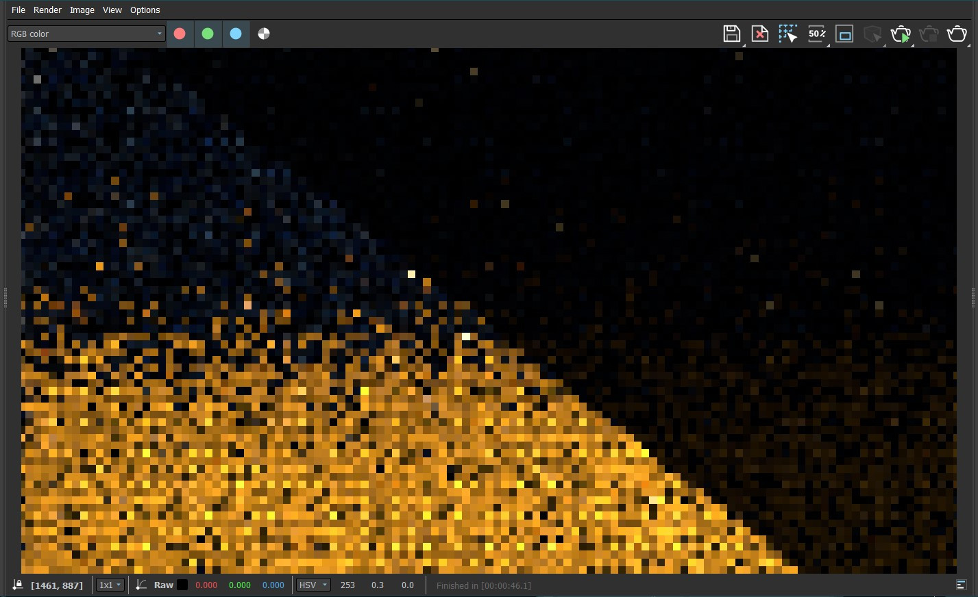

        Running more tests it appears V-ray is randomly losing the scale and or position of objects in the scene and my camera ends up inside something, hence the black frame.
        Very strange!
        The orange mess render is from the camera down near the ground.
        Then I zoomed far out and rendered again to see what was going on and the objects are going haywire.
        I'm assuming my camera is ending up inside something.
        Then if I reload max and render, its perfectly fine.
        Tried resetting xforms on things. Nothing fixes it except a max reload.
