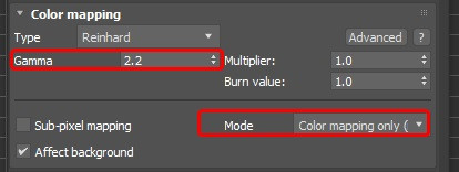

            Hi, please make sure you have set up your 3ds Max, V-Ray and VFB settings as in the screengrabs below

            These are the default settings and with them you should have correct Linear workflow.
