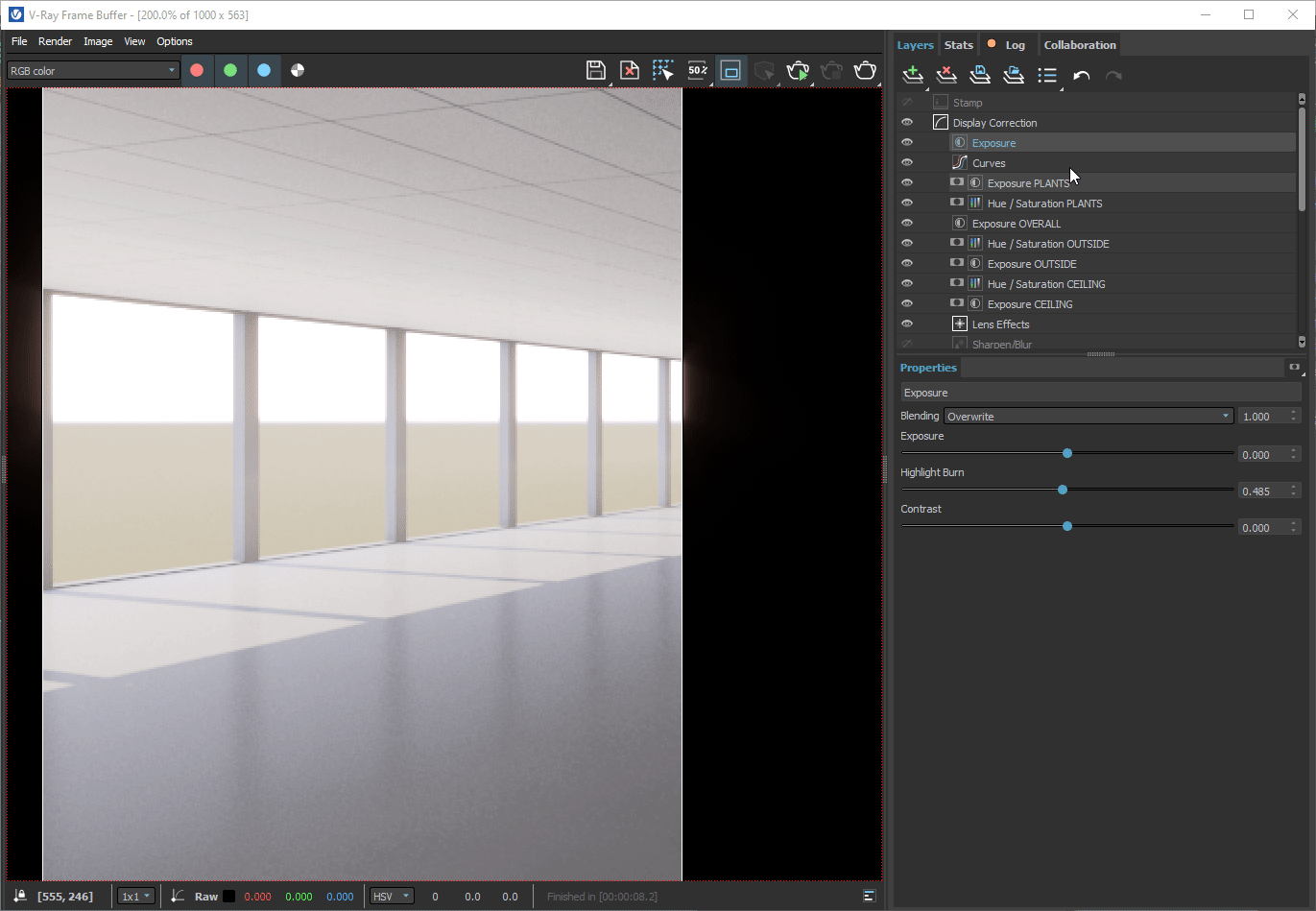

      Hi, thanks for posting. From your scene is this what you are trying to do?
      Vladimir Krastev | chaos.com
        Hi, thanks for the reply, yes that’s what I’m looking for, is there a way to affect just the burnt out areas around the glazing ceiling instead of the whole image. The highlight reduction & filmic filter affects the whole image and will make the fabric and floor finishes look different in the final design.

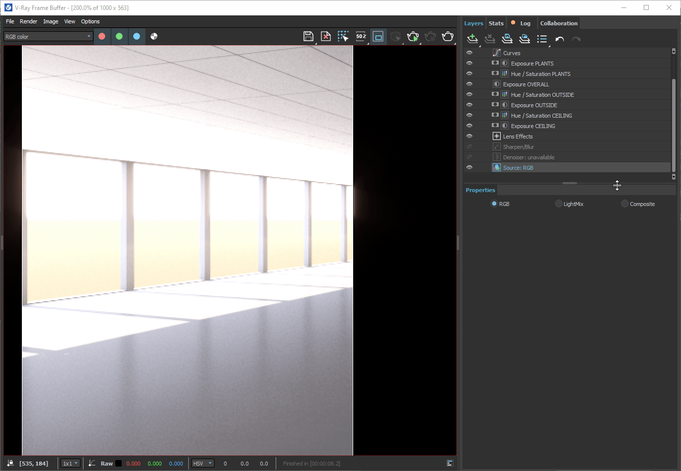

          Are these the areas that you refer to:
          You could use masks in the VFB and also one way to adjust only the area with direct lighting is by using the VRayBackToBeauty
          With VRayCryptomatte mask you can add the exposure layer only to a part of the image:
          With VRayBackToBeauty you can adjust only certain parts of the composition like here for example the direct lighting:
          You can combine these method and gain really good control over your lighting.
