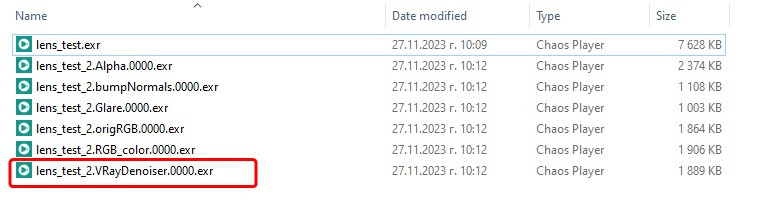

    Hi, thanks for posting. What version of V-Ray are you using? In V-Ray 6 there is a separate channel with a _VRayDenoiser suffix that keeps the denoising effect without the lens effect.

      Hi Vladimir. Thanks for the response.
      I'm using V-Ray 6 1.2. The VrayDenoiser element has a slightly different look to it compared to origRGB and RGB_color. After some testing, I think it's not baking the information from the Filmic tonemap layer.
        Hi, you have to enable the Save VFB colour corrections to render elements checker:
