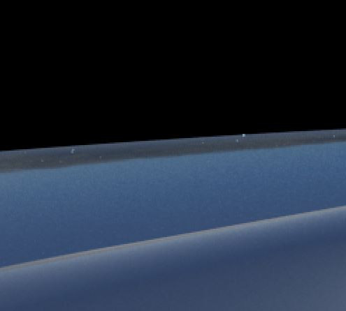

    Hey guys,
    I have a problem here where a Falloff map in the glossiness channel is causing excessive noise in the reflection pass, see attached screenshot.
    The material is a clearcoat which later gets blended with another material.
    The noise goes away when the mode is set to Fresnel or something else, but for look development reasons the Falloff has to stay as it is. Raising Min AA to 24 or even higher does not help.
    Max 2023.2.2, V-Ray 6.00.20
    Click image for larger version  Name:	Excessive_Noise.jpg Views:	0 Size:	53.7 KB ID:	1196023
    Scene file is here: https://transfer.px2.de/_8ZZcd15wNdV5AR
    Regards
    Oliver
    EDIT: Setting Falloff mode to Fresnel does not help either, along the rear edge the noise is still visible.
    You're using a very long GTR tail (i.e. set at 1.55 instead of 2.0: Click image for larger version  Name:	image.png Views:	0 Size:	1.4 KB ID:	1196116​) and that long tail will always be noisier than the default (GGX was chosen for very good reasons.).
    You'll just need many more samples for it to converge (the sampleRate RE indeed shows a ton of red.), a slightly tamer HDRI, or a tighter GTR tail falloff.
    On the plus side, the higher sampling will be concentrated where needed.
    P.s.: if when converged the noise is visibly still too high, you're left with lowering noise threshold until you're satisfied. You may need to also increase max AA in case, to ensure you are indeed converging to the set N.T. (meaning little to no red in the SR RE).

      Thanks Lele, I will try this.
      Regards
      Oliver
        Yep, it's working. Thank you so much, Lele.
        I wouldn't have thought that such a high Max AA was needed for a still image. Most of the time we use those values for very high-intensity lights on motion blurred (remember the fast-spinning high gloss rims?) or out-of-focus parts of the image.
          High sampling is needed any time there is a task that's hard to converge: all of those you mentioned surely qualify.
