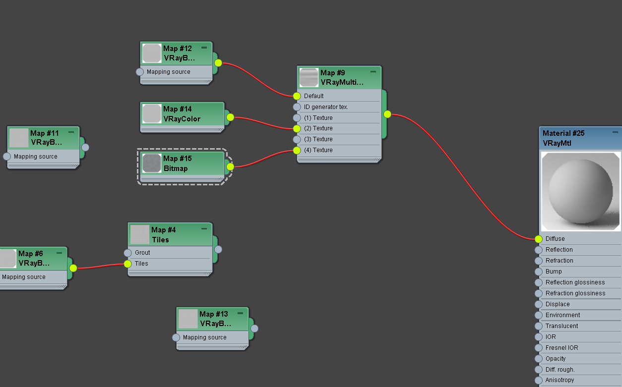

Hello,
I have downloaded the the 6.2 version everything seems pretty fine but there is a problem with VRayMultiSubTex I couldnt connect bitmaps to the texture slot I want. its always slip to the down slot, even you try to attach with another map it went wrong. I cannot fill all the texture slots its always slips. For example; If I you want to connect a bitmap to the Texture-1 slot it is slipping to the Texture-2 slot, and it is breaking Texture-2's existing bitmap connection. In the attachment file I cannot connect Texture slot 1 and 3 it's slips to others. It's frustrating to have that issue while you are working with complex material.
I hope you gonna fix that soon cuz I commonly using VRayMultiSubTex map almost my every work. Thanks!
