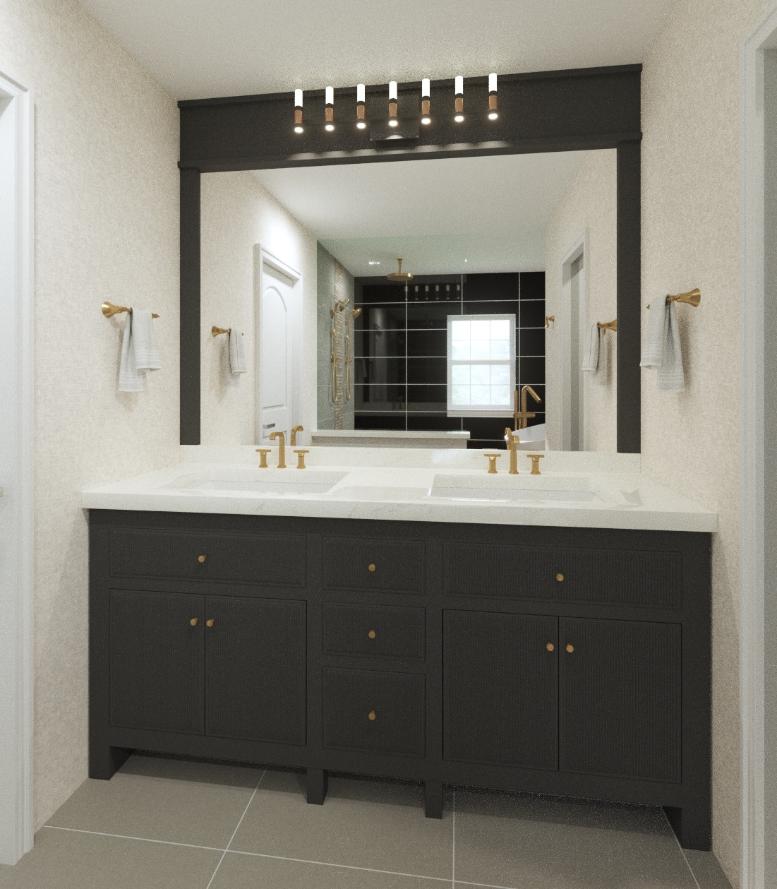

    The mirror in my scene is reflecting the tiles in the background as black when they are actually white. Any idea why this could be happening? I attached two images, one showing the mirror with the reflected black tiles and the other showing what the tiles should look like (white). Thanks.

            It does have bad geometry, as in the attached, however the problem is that you had it set to be invisible to reflections
              I am not sure why the geometry looks the way it does on your end. I attached a screenshot of how it looks in my scene, and it seems totally fine. But anway, yes I do see that I had visible to reflection/refraction turned off accidently and that did fix the issue. Thank you for your help.
