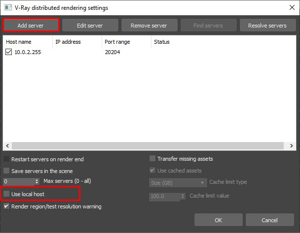

    Could you render a test with only using your workstation for distributed rendering.
    To do that, add the workstation's IP address and disable "use local host" checker
    If you render with no issues I would say the problem is with the network configuration to your render nodes.
