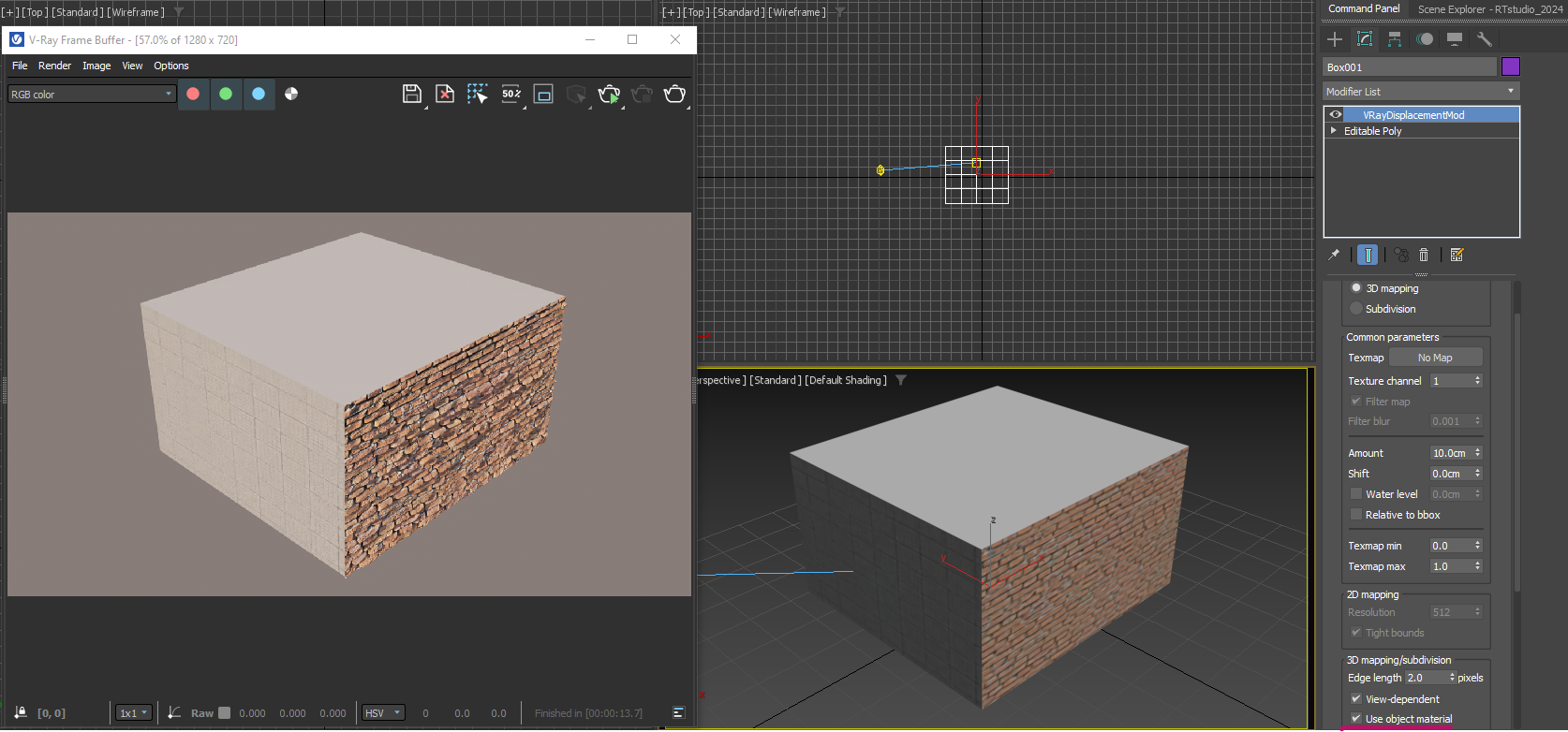

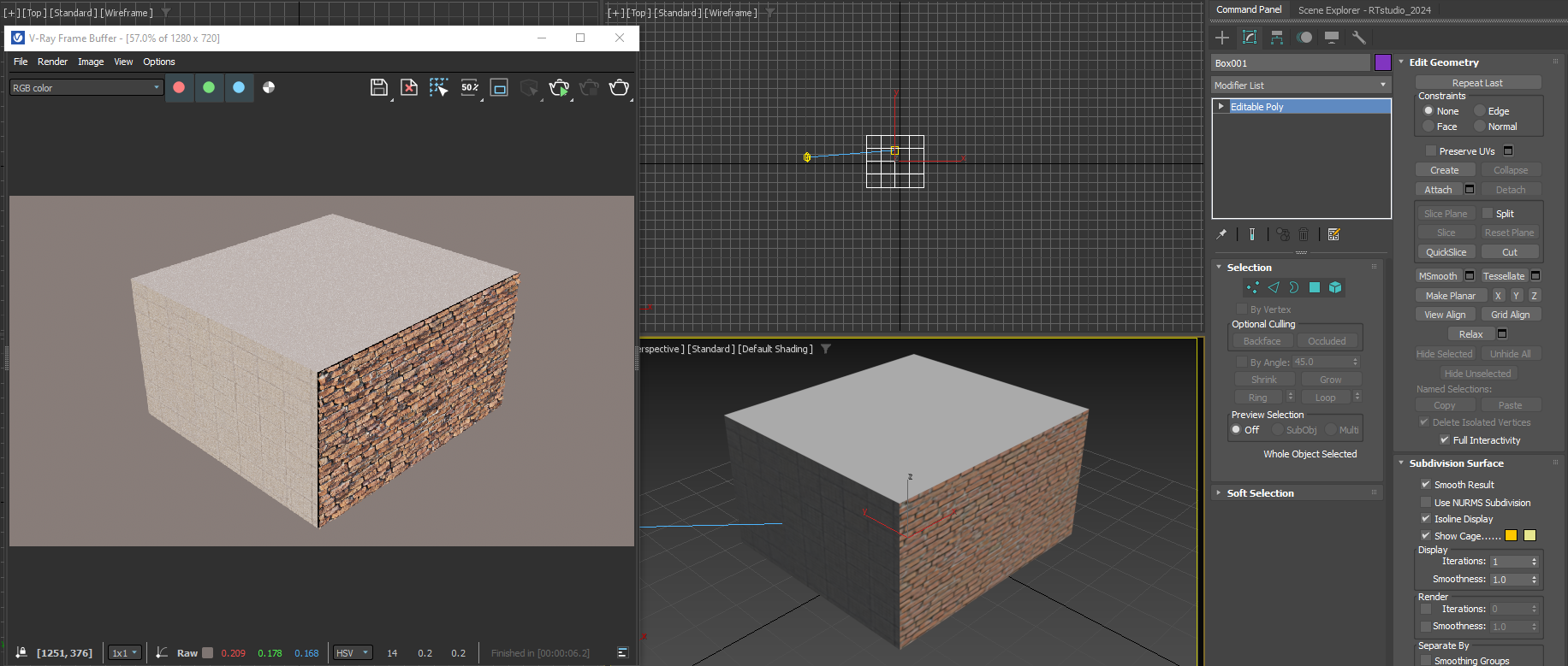

    Not really, even without VrayDisplacement Mod, displacement its only applied to the part where has it (while with modifier you need to activate "use object material" just like you said).
    Could you share your material and modifier setup?
    "use object material" in Displacement Mod

    No "use object material" on Displacement Mod

      Thanks, ChuckRT. I found what the problem was! The "Shift" parameter of the VRayDisplacementMod modifier shifts the whole objects, not just the materials with displacement. If I set Shift to 0, things look correct. Unfortunately, the displaced geometry now expands too much and I can't shift it back to it's original place as this will shift the whole object. Is there a way to shift it in the material?
