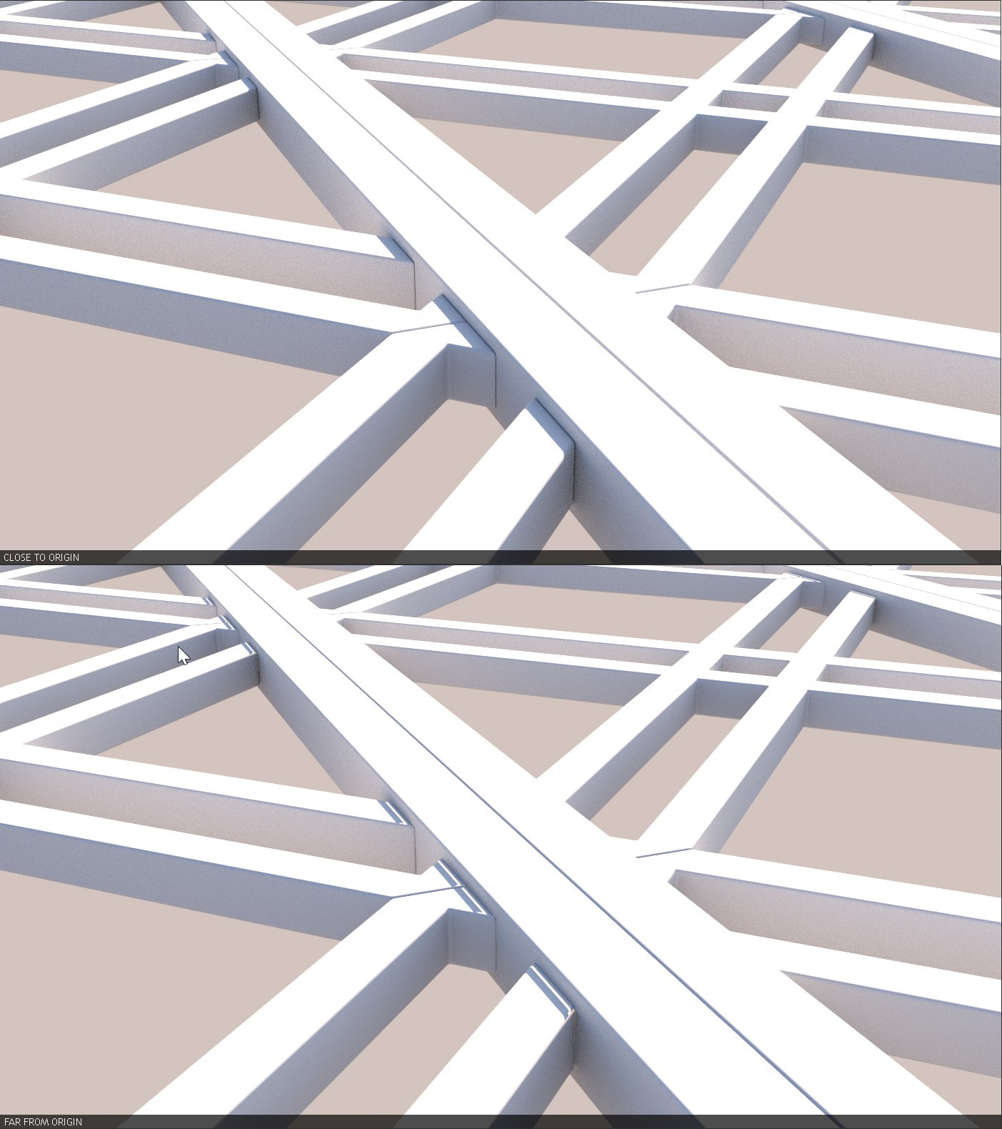

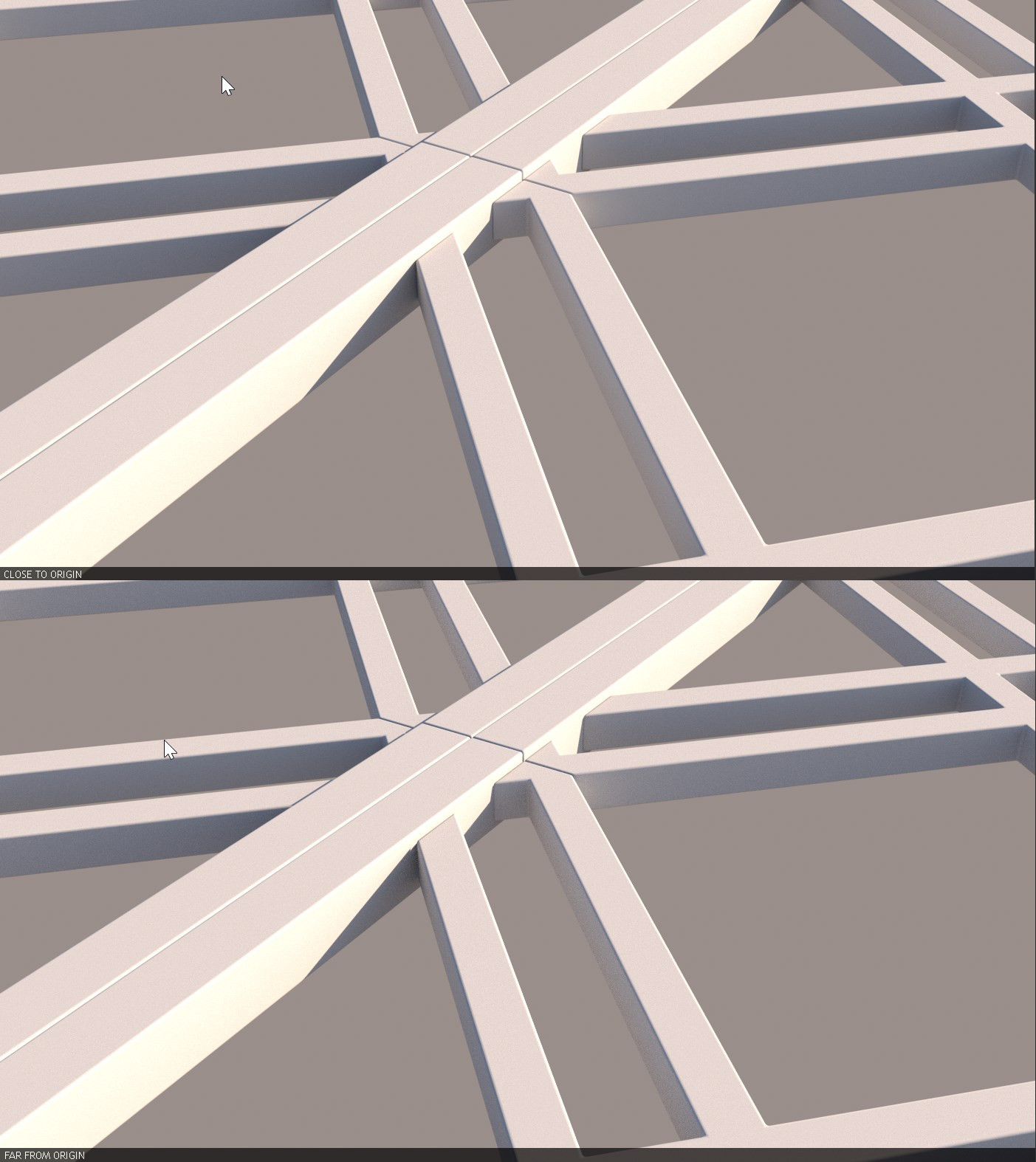

                    Ok, so after further testing it seems that having the Enmesh far from origin will still render wrongly, as in the attached examples.
                    Also the GI is wrong, which makes sense.
                    If you use an array of the original geometry as a comparison, for example, then everything works fine.
                    So it seems it's more of an Enmesh issue here.

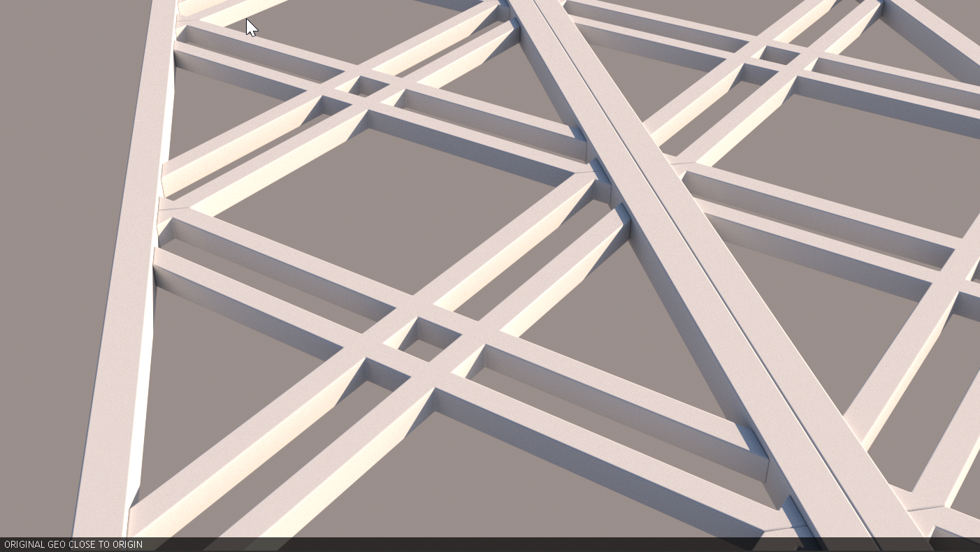

                      This is the original geometry in both locations, just for confirmation
