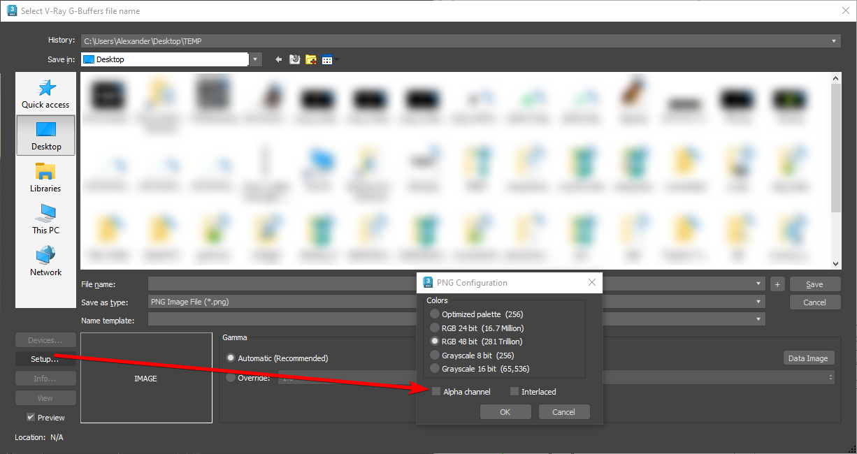

    When I render with PNG as the Output file the sky (which I added when using VraySun) no longer appears in background even though it is there in the VFB. It works fine with jpeg but I want the additional quality I'm getting from PNG files.
    You should disable the "Alpha" saving in the .png through the Setup menu in the Output window. Check screencap.
      Thanks, this worked! Can't believe I overlooked this...
