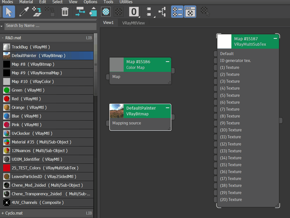

    As you can see in the attached gif, the connections slot in SME Max 2024 have some troubles.
    All the textues slot connect in slot+1, an delete fonction does not work.

    That's odd. Works fine on my end. Which V-Ray version and 3ds Max update do you have installed?

      Hi, thanks for posting. I am not able to reproduce this issue on my setup. I am using V-Ray 6.20,02 and 3ds Max 2024.2.

        Thank for your very quick answer. We are on the 6.20.00 vladimir_krastev.
        It the delete connection by click on trashbin icon or "del" keyboard hermit.crab
          Please update to the latest version and test again.
          Vladimir Krastev | chaos.com
            OK for us with the last version. Thanks a lot
