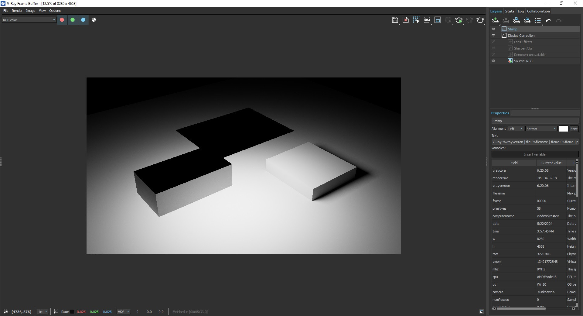

      For instance a simple scene like this
      If we exclude one of the boxes the render time is 5 minutes but with both boxes included the time is 7 minutes (10K resolution with high settings).
      We might need a scene in order to help you better. Please archive it and send it here or through the support contact form.
