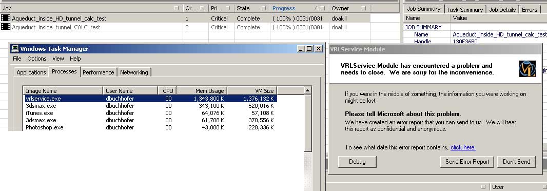

yeah thats exactly what i've got. over 1.3 GB memory usage at times. normally it sits on about 4Mb but everything now and then something goes wrong.

When the problem occurs, Max starts running very slowly and eventually crashes. I',m not sure whats starting the problem but think it may be when i click to network render....it can sit there for a long time before the dialogue shows up.

Starting the vrlservice.exe begins at 6mb of ram use. every roughly 20 seconds it allocates an additional 2008KB-2036KB of ram. This is with 0 network renders running currently, so my above guess about it being related to licence requests seems to be false.
Edit1: Removing my dongle from the workstation causes the same above behavior.
Edit2: Trading dongles with a coworker has the same behavior.
Edit3: Removing myself from the network completely, and the vrlservice shows the same behavior. I only watched it grow until 60mb.. but from what you say above, thats already something very wrong
