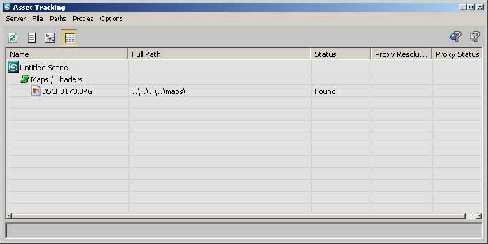

                                Forgive me, maybe your problem is more complicated than this. But could this missing map problem have something to do with the "Use relative paths" feature of Max9?
                                Use the Asset Tracker to check.
                                A Relative Path looks like this and will not work for DR or BB renders.

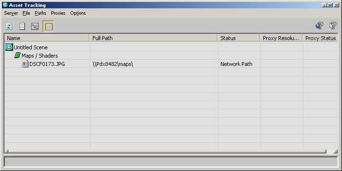

                                All the paths to your images should look similar to this in the asset tracker:
                                PDX8482 is the name of the computer with the shared folder "maps" that contains all the images.
