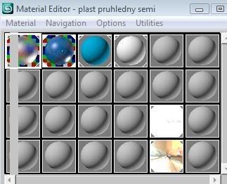

    blue on the left is RGB (0,113,18 gamma 2,2 within color correct
    blue on the right is the same RGB through vray color and gamma 2.2 applied, no matter what option i choose within vraycolor i get this

    What is the gamma type set to? It should be set to "Specify".
    Vlado
      thats the thing...when i se to specify...it stays ther same..nothing happens with the color....do u want me to send you the scene so u can have a look?
