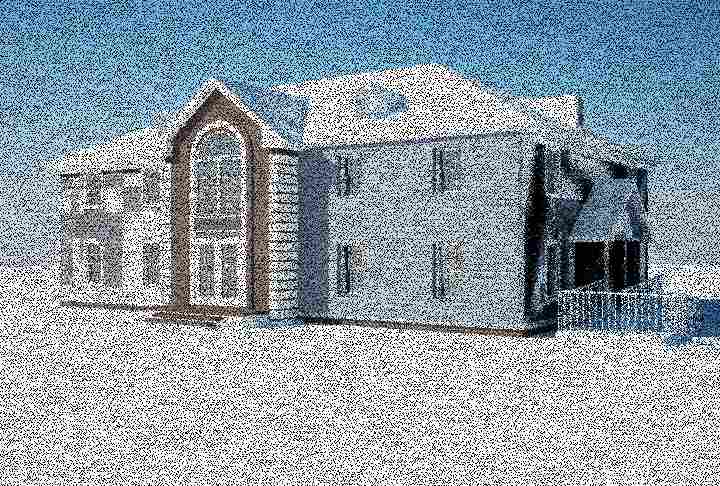

    I can not figure out what happened...I just did a bank scene and I have another building and I just re imported the new scene into max and look at the siding!! If I move it up or down, it is fine. The siding on the right I moved out a little so you could see. Weird. Any suggestions are helpful.

    It looks like double faces there. If you increase the secondary rays bias to e.g. 0.001 does it render fine?
    Vlado
      yep 2 copies of the same building in the same spot me thinks

          if it aint double meshes then i can be a incorrect mesh. try welding verticies and if that does not work then create the part again

            It isn't two buildings in one place...Just checked. Gonna try the bias thingy.

              Oops....Well...It wasn;t two building or faces in a way. When I built my wall in Arch Desktop....I accidentally had the Bandtrim component going to the top of the wall instead of stopping at 2'0". Hehe...Thanx all.
