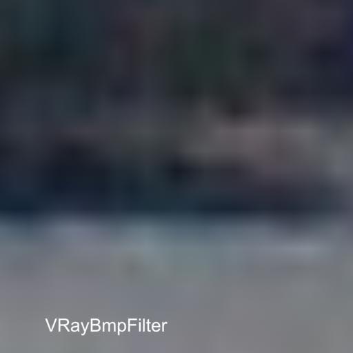

              Originally posted by pixelstudio View Post
              It seem the vrayBMPFilter applies also no filter, so that will give the same result as filtering none.
              Not exactly, there is a difference if you look at the map from really close, like the attached images (the VRayBmpFilter image is more smooth). If you look at the image from far away though, the difference between the two is very small.
              Vlado
