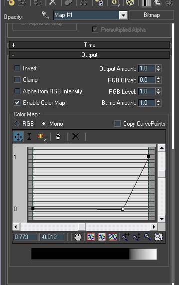

      Try changing the curve in your output setting for the map you have in the opacity slot. Attached is an image of a curve I set after a similar halo problem. You can adjust the amount of halo clamping by moving the middle point.

        Thanks that fixed it -
