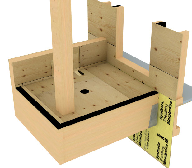

Strange situation here: Rendering still frames, this renders just fine - but if I try to use the pre-pass calculated from the animation mode, these objects, as you can see, render pure black. What could be causing that?
Some objects render black
double faces (coplanar planes) maybe?
Nope & nope. The normals are fine - has worked fine in several previous "draft' animations sent to client. And no, the material isn't using glossy reflections either. In fact we even ran a test with glossies off as a global switch, and got the same output.
Strange that it's working fine now though.
Wait - no it isn't.
Everything was looking good then, around frame 2700, a couple objects randomly turned black. This just doesn't make any sense to me. This has worked just fine on numerous other draft animations (of this exact same max file).
hmm then it's getting weirder by the minute )

Just for a bit of closure - we ended up re-calculating the irradiance map series (5400 frames...), and it rendered fine. It must have been something with the irradiance maps that was causing the random blackness. Definitely strange though.
When we re-calc'd we manually reset all the vray parameters at the same time just to rule out the possibility that one was changed by accident, somehow causing the problem.
