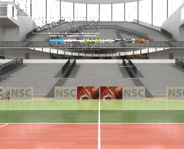

    Hi. Does anybody know what is wrong with
    my irradiance map? It is very grainy even with
    high setting and it produces useless outputs...

    The irradiance settings look fine to me, but those black splotches on the precalc image are weird, how is the scene illuminated (VRaySky, HDR, ..)? Are you using an SkyDome or are you lighting with an environment map? Which settings do you have on the DMC sampler settings?
      The scene is lit by sky dome. I realized that this
      problem is not scene specific. At the first image
      is same scene rendered with light cache/brute force.
      Problem started today. In the morning my irradiance
      maps were looking OK. I have rendered other scene
      and as you can see irradiance map is very grainy too.
      On the third image is correct look of arradiance map.
      I have reinstalled Vray but without success...

        check ur dmc sampler noise treshold, and increase the irmap interpolation samples, see if that helps.
        Nevertheless there seems to be not enough light samples coming in...
        but its dificult to judge from that info.

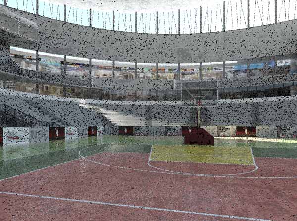

              You can try to increase the dome subdivisions. If you have checked 'store with irradiance map' try 100 otherwise 20-30 should be ok.
              Post your DMC Sampler settings. As ene.xis said, if noise threshold is too high it can produce splotches too.
                I tend to get this problem a lot on interiors that are lit mainly by smallish windows into a large space. I usually just up the Irr. map samples to ~100/50 and it clears it up. I really don't know what's causing it though so these seatings may just be overkill when a quicker tweak somewhere else (maybe the DMC noise) could clear it up.

                  I would think you have to much samples. In my opinion the default presets (medium/high/.. etc...)
                  are not optimal for High dynamic situations like Skydome, Vray/IES Sun or overbright lights.
                  I also do a lot of interiors and usually I have to tweak the tresholds by myself to get decent rendertimes and clean images.
                  Here is an example how a scene comes out with medium settings (like you posted above)
                  (show samples on, Vray Sun/Sky, Log. Exposure)
                  This is how a custom tweaked Irrmap turns out. Imo this is how a sample distribution should
                  look like. Few samples in regions like walls.. where not much indirect shadows are
                  happening. And much samples in regions like corners.
                  I used the following settings to get this distribution. You can give it a try, but it may
                  vary from the dynamic range of your scene as well as other factors. Play with the
                  tresholds to get a similar distribution like i used.
                  The final image.....
                  Hope that helps,
                  cheers,
                  sam
