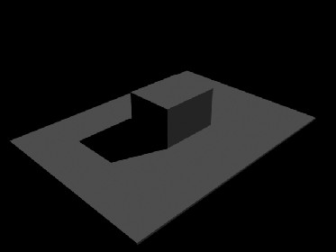

    hi, i just realized that the render elements for shadows(vray matte shadow, vray shadow, vray raw shadow) seem only to mask the shadows which are thrown on an object, but not the shaded areas of the objects.(see attachment).
    1.) is this correct or am i doing something wrong, and if, what?
    2.) if this correct, why the shaded areas of objects are not masked by the shadow re of vray, as they are in the render elements of the scanline renderer? for me it`s not usefull to have only on part of the shadows to control in post.
    another question:
    i also realized that vray render elements for shadows do not mask areas which do have max materials on them.
    again, is this correct, or am i doing something wrong?
