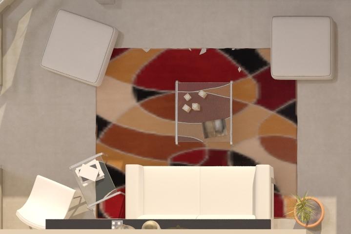

    Here are three images:
    link
    The first one has the Color Mapping Gamma set to 1, the second one has the Gamma set to 2.2, the third one has the "Don't affect colors (adaptation only)" box checked with gamma set to 2.2
    The one with the gamma 2.2 with the "Don't affect colors (adaptation only)" activated has "blowouts" occurring in object close to white colors, under sunlight. There is no white 255 in the scene, the whitest color has a value of no more than 245. I assumed that the don't affect colors affected only dark areas giving more definition to areas in shadow. Is there any reason that it is blowing up materials close to color white? Are there some limitation to using the "Don't affect colors (adaptation only)" check box?
    Do you have other color mapping in addition to the gamma value? The "Don't affect colors" option causes V-Ray to ignore all color mapping, not just the gamma.
    Vlado
      Ah! I see now how it works... I did have the Burn Value set lower, at .5 using Reinhard, did a test with the don't affect colors and it came out like a render with the Burn value set at 1.0
