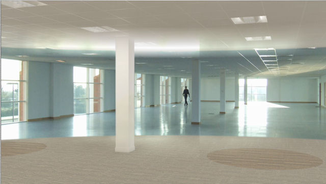

          Hi Anders,
          I've done the colour rolling in from the camera thing using the z-depth as a matte in Combustion. These are stills taken from the test movie, I used live footage as the starting point but you could use your scene rendered with a grey override material.
          Hope that helps,
          Dan
          Dan Brew
