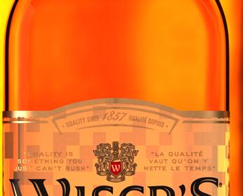

        Have a look at the two attached images: they are both crops of the VrayCaustic element from a bottle render. The one shows the bottom of the bottle and is the area I was actually concerned with and set the caustics for, but the other shows the upper part of the bottle and the problem is evident there. I cranked up the exposure to show it more, but you can see how chunky/blotchy that part is. It almost looks like caustics are not working with the smoothing on the bottle or something.
        I have seen this on other images and in some cases it looks more like buckets getting hit differently. Any idea what can cause this so I can smooth out the whole image properly?

          This doesn't look like bucket artifacts to me - more like too low caustics settings. What are they now?

              I went back and re-rendered a part of that file where the problem looked more like buckets dropped. See attached - it's the VrayCaustic pass, and the RGB pass. The settings are slightly different in that file, but basically the same sort of setup. I rendered this file exactly as is, but without DR and it worked okay. I will re-test that to be sure as well.
              b
              EDIT: I can confirm this problem only happens with caustics and DR on - although the chunkiness in the first post seemed to happen either way. I guess it is two different issues?
