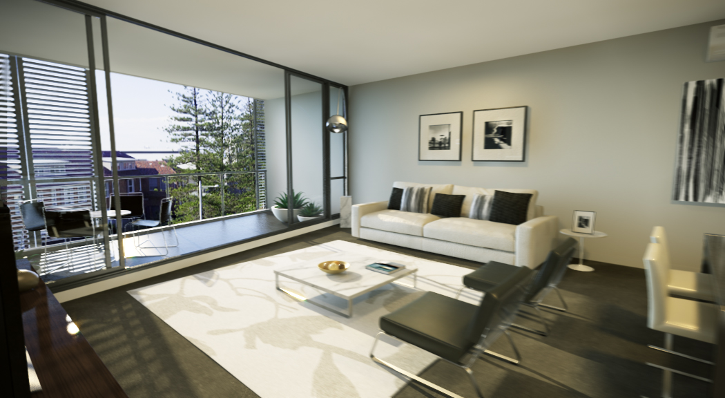

    hi guys,
    I am experiencing a problem getting out vrayVelocity pass with objects that has close proximity to the camera. Did anyone experience this and can shed some light to what I am possibly doing wrong?
    - VrayPhyCam Clipping "On" {turning this off does not seem to affect the outcome}
    - Near set to "0m"
    Attached are images that illustrate the problem.
    warmest regards,
    Jung

      Rendered Frames of the Illustration
      Here are the according frames of the Illustrations
        what is the vray version? also it looks like your actual renders have motion blur in them already?

          Vray1.5 SP2 - upgarding to 1.5 SP3 is not an option currently.
          Sorry I have posted up a comped renders using RSMB Pro 3.X .. not the raw renders.
          The near clipping value in the vrayPhyCam does not seem to affect the problem... unless set to a negative value.. which works.. but also at the same time produces results that is not wanted. (ie. seeing the backside of adjacent wall etc)
