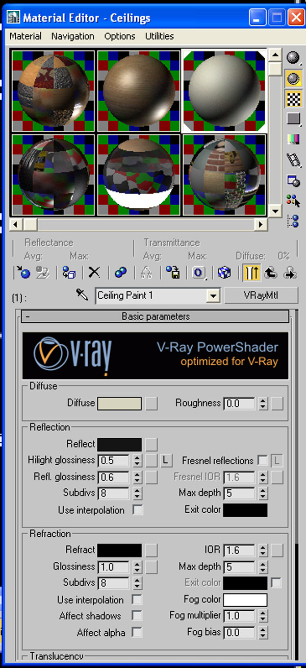

    I've read several posts relating to blotchy renders and tried all the suggestions to solve the problem but in this case nothing is working. I've changed the Hsph subdivs/interp samples/min & max rates/Global subs multiplier/light's subds/material's subs/interpolation types & sample look ups and nothing is making any difference.
    Is there anything I am missing or should be looking at changing in my scene to get a smooth render?

    What does the material look like? It looks like the material and mapping is that way rather than blochiness from low settings.
      Blotchy render issue
      It's a simple Vray material with a diffuse colour & low reflection-not rocket science. I have similar materials in the scene which have rendered perfectly but on the cornice it doesn't want to play ball.

            Test with material override
            Test with grey-material override to spot if the material is the problem...
