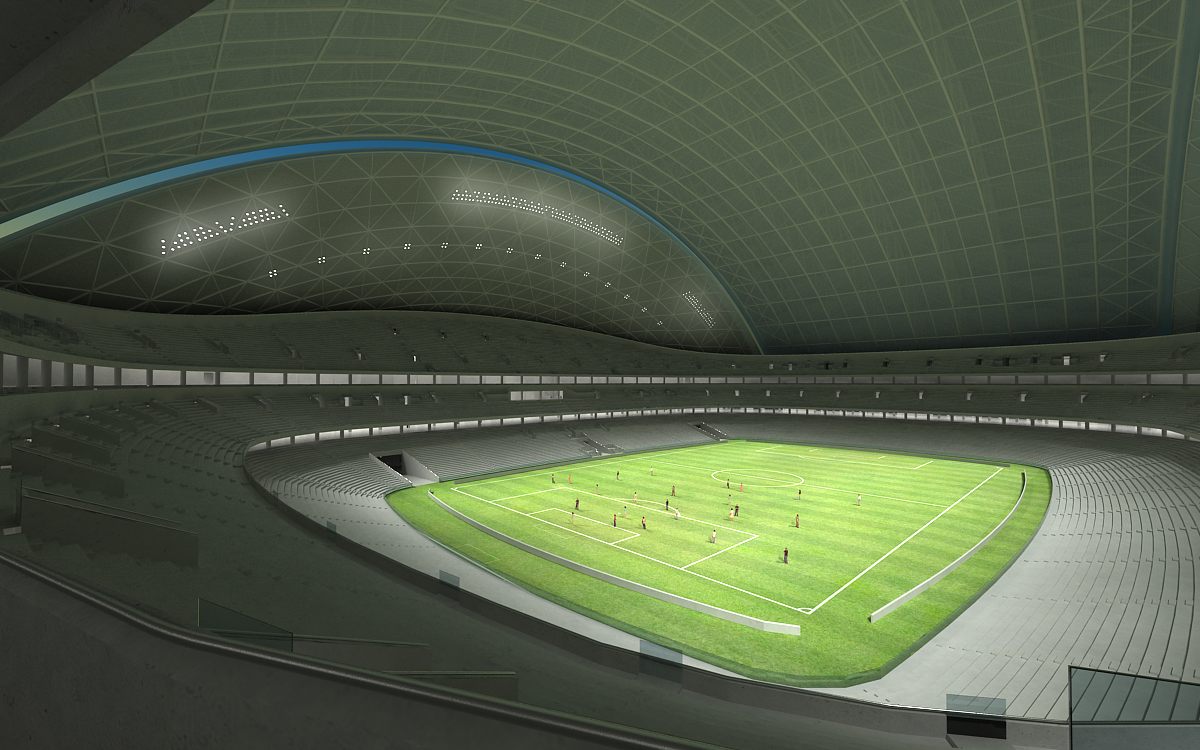

    After installing SP3 (or SP3a) vray renders exactly the same file very differently to SP2. Please see the attached images.
    The problem happens on geometry with flipped and double faces when using irradiance map.
    Sp2 didn't have any problems with that. All I had to do was to use 2 sided material and increase "secondary ray bias" to get clean render. But in SP3 the same file renders differently, with dark blocks caused by double/flipped faces.
    Something changed in sp3 that causes the irradiance map to calculate differently. Is there some setting I can change to get the irradiance map in sp3 calculate the same way as in sp2? Should I do something with the material? Fixing the geometry is not really an option.

            Thanks for your offer to help. At the moment we are trying to debug the scene by ourselves. With some results.
            What happens is, when we render the scene created in SP2 with SP2 the result is image 1 (see below).
            When we render exactly the same file (nothing touched) in SP3 the result is image 2.
            In order to get clean render in SP3 I had to merge all the stuff to a new file, then bingo! (img.3)
            This is very strange for renderer to behave so differently from one service pack to the next. I can only hope we will not have to go through this process too often.
            Marek

                  It doesn't make any diffference. Aren't current render presets saved with a file? I still tried it.
                    settings are in the file yes - maybe sp3 translate some values incorrectly
                    all I can imagen is a unite scale problem or similar
                    so far I support sp3 noone ever reported such a problem
                    can you try to lower or rise the "seconday ray bias" in vray
                    are you using GI "from file" made in SP2 and reuse in SP3?
                    disable GI and compare render again

                      Hi guys !
                      I've had this kind of problem (black zones in sp3) and found the way:
                      the "check sample visibility" option (irrad map settings) is perhaps ON. Try to uncheck it, and the black things will just disappear

                        Hi Subburb
                        That's exactly it! Thanks a lot for help
