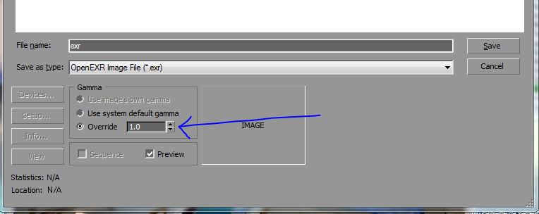

            What I do is Override the Gamma to 1.0 when saving the file.
              hey
              yes i do the same i apply the 1.0 in 3d max before its much easier.
