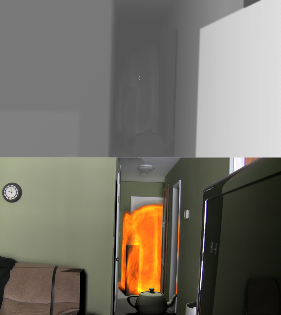

      Thanks for the response Thorsten. With FumeFX, which operates on similar volumetric principles as EnvironmentFog, a depth pass is possible (see attached for crude example). It relies on the depth information and the alpha channel of that depth pass to give decent results. I was hoping for something along these lines if VRay was unable to do it in a single render.
