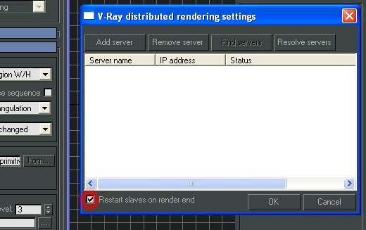

                    We've also had this problem at our company but resolved it in a different way.
                    We think the reason why the black buckets occur is because the Vray spawner was holding onto old data from previous renders. Probably something to do with the network connections. We've even encountered buckets that render from a previous scene. We've often had to do these fixes:
                    -Re-saving the scene with the distributive render button checked sometimes helped.
                    -Relaunching the V Ray Spawner on the slave machines always helped, but if you have a lot of machines it might be daunting.
                    What version of V Ray you have? Because in version 1.50.SP3a there is a check box in the Distributive Render Settings tab called "Restart slaves on render end". (See Attachment) This will reset your slaves back to normal. If you have an older version of V Ray the other two suggestions should work.
                    As for the X-Ref problem... Is it rendering the Xrefs in the buckets that are good? Because if it is rendering fine in those buckets than i would say.. Xrefs aren't the problem.
                    The only real problems I've had with Xrefs was when i was X-Refing from a different drive. Such as textures library on a different drive. So i suggest keeping everything your X-Refing on the same drives. This will also help if you have to Archive a project. Ive found that archiving jobs with stuff pathed to differen't drives sometimes it would miss textures.
                    I hope this info was helpful...
                    Good luck
                    -Fizzgig
