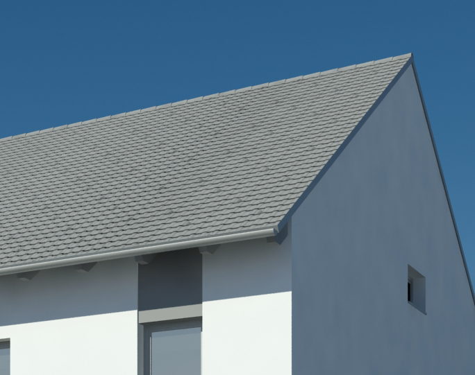

    i face the problem that my roff tiles appear too flat. i think a displacement map could fix this.
    the problem is, i have none for a roof with roof tiles.
    Would be thankfull for infos where i could get one. (best would be for free)
    maybe these two approaches can help you out.
    --> http://www.pixelab.be/blog/2007/09/2...ling-geometry/
    --> http://www.vray-materials.de/all_materials.php?mat=1691

      Thanks for the 2useful Links toby. Sorry for answering so Late. I solved the Problem with à vraymaterials.de mat. Greetings max
        If your roof is simple [as in your render] then you could build tiles with geometry better & quicker than you could search on google for a good texture. [should take no more than 5 mins]
