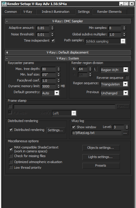

    I have been having this problem recently... I am not sure if it has to do with my settings, or the fact that the model originated in Revit.
    For some reason I am getting black lines in fine details of me Revit model. I can usually crank my settings, and get rid of them, but that solution does not always work.
    I have checked, and there is not coplanar faces.
    I usually try and solve the problem by cranking up the Clr thresh, the Nrm thresh, and the Dist thresh in the Irradiance map rollout. This rendering was done with them all set at 0.6, but I still got the problems of the black lines.
    I also have my secondary rays bias set to 0.02.
    This particular rendering is being rendered at 2000 pixels wide, and the GI passes were calculated at that resolution.

              One of the wierd things is that they are not consistent. If I change resolution, or move the camera, the location of the black spots will move on that object. This is why I was assuming it had something to do with sampling at the GI level, or possible the DMC/AA level. I just can't seem to figure out the solution.
                Also, I realized late last night that my problem is not limited to Revit geometry. The specific piece I have circled in my post was constructed in 3dsMax.
                  Ok. I solved the problem. Well... not so much solved it as got it to not do it anymore. I set the rendering engine to scanline, rendered, and then set it back to Vray, and re enabled all my custom settings. No black dots.
                  So, .....whatever the problem was, it was fixed by resetting Vray.
