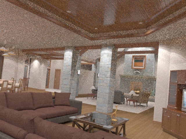

    I have this interior scene that has a huge render time. I have a lot of IES lights, but other than that I don't see anything that would warrant a 106 hour render time, do you?

    Does it change a lot if you make all the ies lights use the same file? If so, maybe there are some bad ies files...
    Does the time change drastically if you turn off and replace the VRayIES lights with some standard vray lights? (just for a test)
    Damn that's a long time though!
      try an override material to see if materials are doing it. maybe displacement?

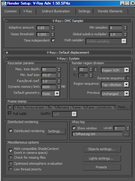

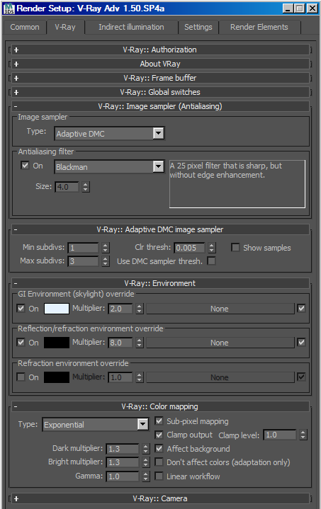

                    hi, i just opend the scene. i think there are more things to tweak... first thing i get is the lc passes is set to 1. as your pc has more than one core, you should use them. set the lc passes to your number of cores of your pc.
                    second is the dmc sampler. try to set it to the default values. you set the min samples to 171 and the global multiplyer to 4...
                    third your maps seem to be a little to big. what size is the displacment map? i think it is 3800px wide. try to you smaller maps. 1024 px are surely enough, as long as the stones aren´t in the front.

                        Heya
                        There is something strange in ur scene. Its the second time I encounter it... Basically out of 8/16 threads my pc is using only 1 cpu/threat to count LC. I did remake all the settings.
                        Anyway, Vray-RT render it just fine After 1-3 min I got this: / Gama is mess up, I've customized mine slightly... doh!

                              I was getting really nice images in hours using all the same maps. All of a sudden my render times sky rocketed and it was when I cut holes in the ceilings and dropped cans in with the IES lights.
