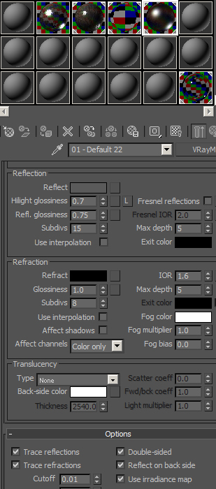

    Hello guys,
    I got strange problem with vray materil, means I dont have reflection on the material. All I do like always and always all was fine but some time ago I found problem with reflect.
    All settings are normal, shader is really easy/standar, just gamma I have 2.2.
    Please look to my shader setting, Irradiance map view and render.
    Vray version- 1.50.SP5
    Thanks for replay and best regs,
    Junior

    Does it work if you turn on the "Reflect on back side" option for the material?
    Vlado
      Have you checked in the options material rollout where it has the reflection and refraction checkboxes. I know that when you do a convert scene to vray materials it creates a vray mat without the reflection turned on...
      Regards
      Steve

        Thanks guys for replay but this is not it.
        I tried turn on Reflection on back side and I checked Options slot in Mtl but still not reflection. Interesting thing is this happend only on the plane, flat model like floor/panels(before was OK so I don`t know why).
        Ok but I found another way how I can see reflections is turn on Hilight glossiness and untick Fresnel reflections. New material setting in attachment and test 02.
        Thanks !
