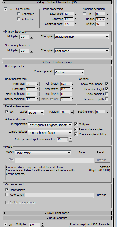

I'm just starting to use IM GI for the first time (always used BF/LC till now). I have it setup with -6/-1 min/max rates and it was rendering okay before, but I've changed some other setting I think, because every time it renders it does the LC pass, then it does only one pre-pass before starting rendering (says 1 of 1).
What other settings (render dialog, maybe materials?) could cause it to bypass the proper number of pre-passes? Is this likely to be affecting render times or quality? I can't really compare and tell now
Thanks for any tips.
