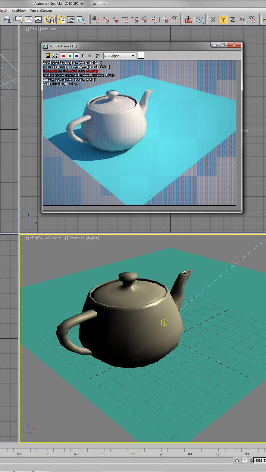

    Hi there,
    Ive just installed the latest beta of vray 2.0 and have some problems when using VrayRT GPU. As the image renders, blue blocks appear over the screen and change in colour. Also the colours are strange for the entire image. It works fine in CPU mode.
    I have a gtx480 graphics card.
    It was working fine in 3dsmax 2010 when using just vray1.5 sp5 and vrayRT GPU.
    Any ideas ?
    Regards
    Steve

    Does this happen on any scene? Can you show an image of how it looks. There aren't any major changes between the two versions.
    Vlado
      Actually I can reproduce the issue here; will be fixed in Beta 3 - thanks for the pointer!
      Vlado

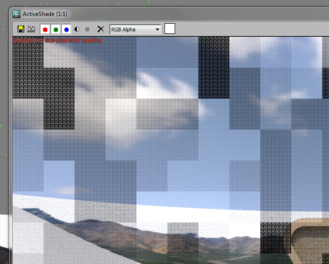

                  Vlado. Im still having problems with this. I have updated to the latest Vray2.0 build which I assume updates RT as well. I still have different coloured buckets. Im using an entirely different scene.
                  Regards
                  Steve
                  My Portfolio
                    Does it still involve the car paint material?
                    Vlado
                      No, a completely different scene with no car paint material used.
                      This is part of the RT window.
                      Regards
                      Steve
                      My Portfolio
                        Ok; which engine is this? GPU, CPU? One machine or many machines with DR?
                        Vlado
                        • #13
                          This is the GPU openCL engine. I have 2 480 GTX cards that are not in SLI mode. No other machines are being used. DR not used.
                          Regards
                          Steve
                          My Portfolio
                          • #14
                            Do you get any errors in V-Ray render server window? What is the memory usage on your GPUs?
                            Vlado
                            • #15
                              Just checked the server window.
                              Memory usage: 111.94mb
                              Error CL_MEM_OBJECT_ALLOCATION_FAILURE (-4) at line 1716, in file ./src/ocl_tracedevice.cpp !!!
                              Thats the only error.
                              Regards
                              Steve
                              My Portfolio
