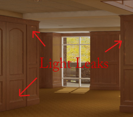

I set LC subdivs to 4000 sample size to 0.001 but still getting those strange light leaks, splotches:
walls have thickness, materials aren't 255 white.

yeah, I got vray light planes in windows and there is not sun light, room is quite big so I guess its' because of this travel distance you mentioned. Setting LC to 8000 starting to help.

Take a look at the light cache itself (select it as both primary and secondary engine). If it is very noisy around the problem spots, then you'll need to increase the light cache subdivs.
Unticking "Store Direct Light" in the Light Cache drop-down fixed the light leak problems. Now I have to work on getting a quality set of images without killing my render time per frame.
Hm, for the images above it would be odd if you need to uncheck this option - it looks like it should work fine. If you wish you can send the scene to us at vray@chaosgroup.com so that our support guys can check what's wrong.
