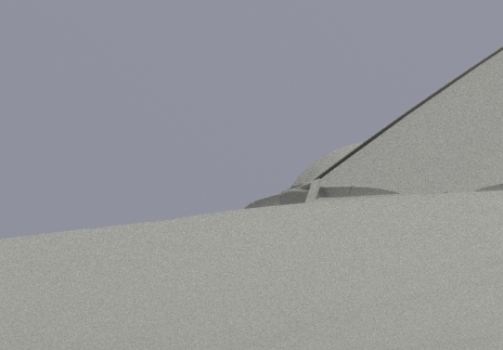

          Yes, I had some time over before lunch to render a couple of tests, and while doing so I accidentally stumbled upon the solution..
          First image is with Dome light. Second is with the HDRI in Env and Irr map as primary bounce. Third is with the HDRI in Env and Brute force as primary Bounce. I guess I need a serious amount of brute force subdivs with HDRI env to sample a noisefree image.
            the dome light does importance sampling with textures, it helps clearing noise in a more efficient way than what you get from the same map in the environment slot.
            at the end of the day you may end up with faster render times sticking with the dome light.
              Hmm, my experience is that you need too much subdivs for the dome to get good quality. Seems to me like an image for Env is pretty noiseless when using Irr map. Yes I'll probably loose some detail, but env is often used for overall lighting and don't have to bring forth detail in the image.
              I'm testing full res (A3) renders now and I get much smoother resault without the dome and much better rendertime.
              http://www.cgpro.se - Portfolio
                i guess increasing irr hemispherical sub div in 'Env_IrrMap.jpg' setup shd help. may be 100+
