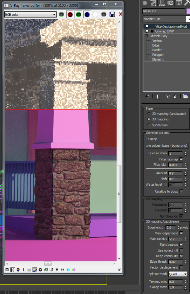

    I have a stone column that isn't displacing properly. My edges are not connecting and Keep continuity is on.

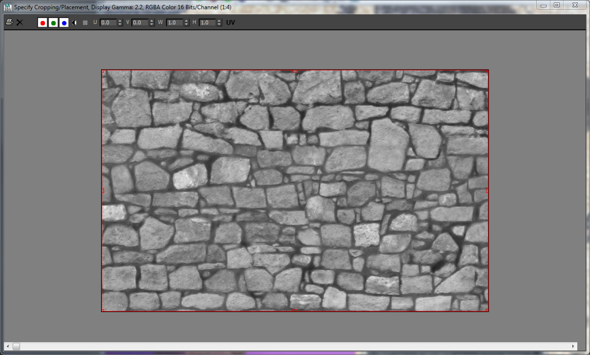

    and here is my bump map

    Are the faces connected? For example, check if there are either 4 or 8 vertices at the bottom of the cube.
      BINGO! Funny... I was just watching a video on xView. Thanks!

        Yeah, xView can help too. You are welcome
