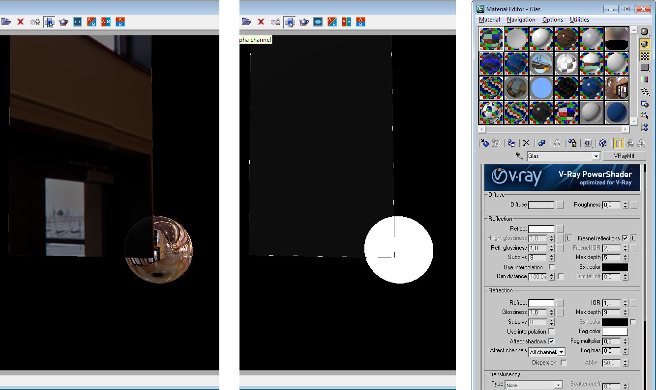

    As you can see in the attachment the reflection map inserted in the reflection override slot is being occluded by my glass material.
    What could be the problem?

    Once it goes through the refraction, the refraction environment will be used. You can try overriding the environment map locally for the reflective material.
    Vlado
      thx, I will try
