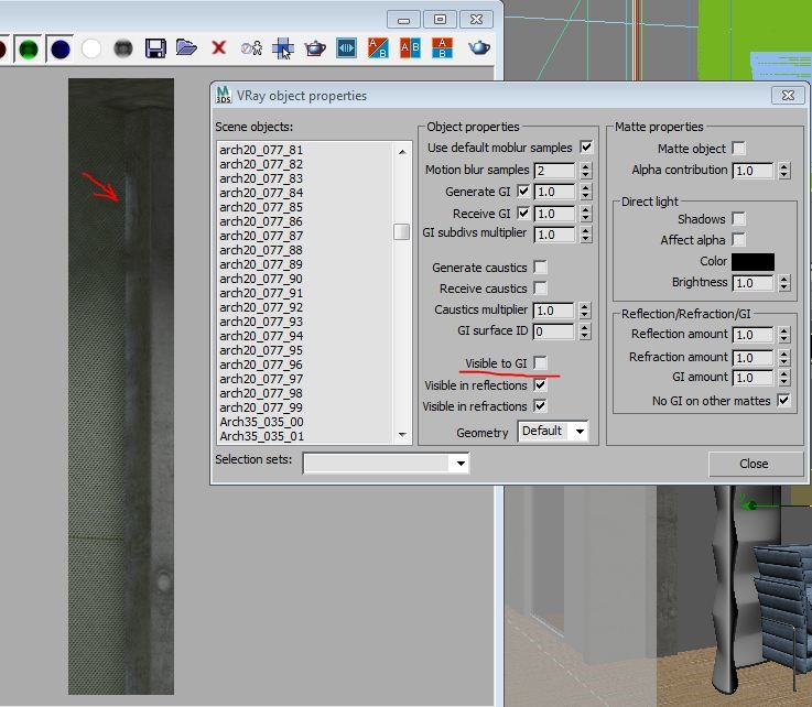

        I'm having the same problem I think, the blotches go away once I switch to BF/LC.
          Why are you turning it off to GI?????
          If it is because the displacement is slowing down render times too much then turn OFF displacement & do your GI prepasses then reload GI prepass & turn displacement back on.
          If your displacement is quite fine you will usually not even tell the difference between having the displacement on or off during GI calculation.
