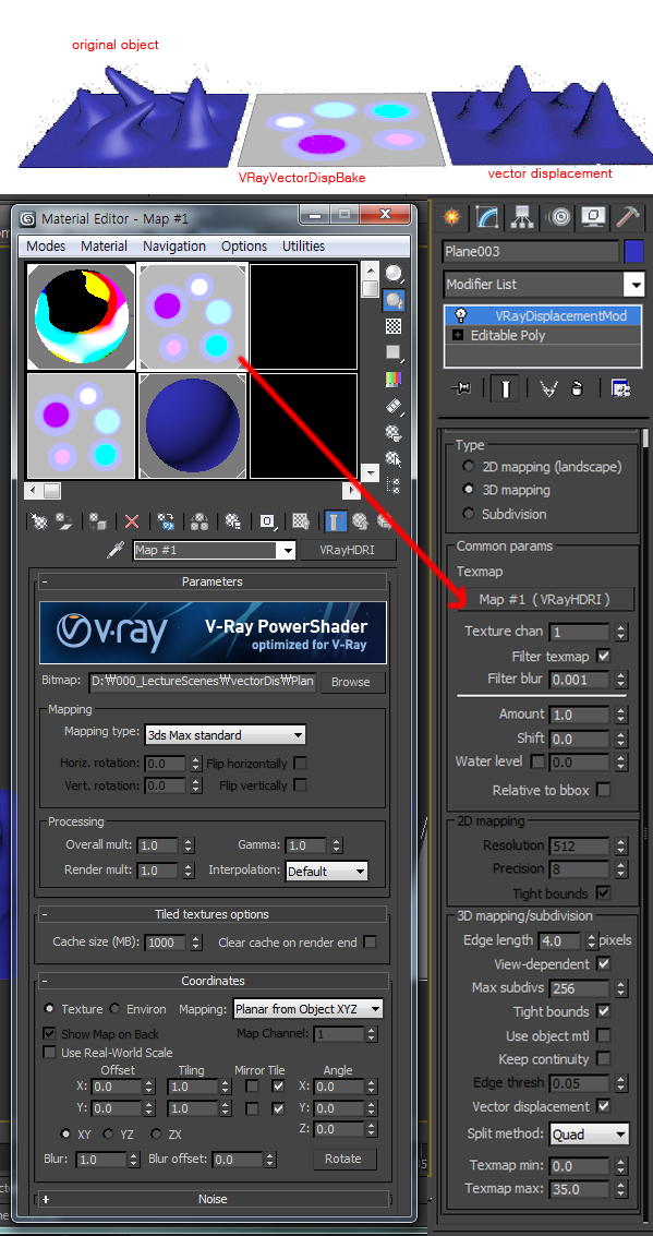

    I am trying to use Vector displacement with V-Ray.
    I got this example but I couldn't get a right vector displacement.
    http://www.spot3d.com/vray/help/200R...splacement.htm
    Example 8: Vector displacement
    Please check this image.
    I just turned on "vector displacement" in VRayDisplacementMod.
    And the image for vector displacement is .exr 32bit file format.

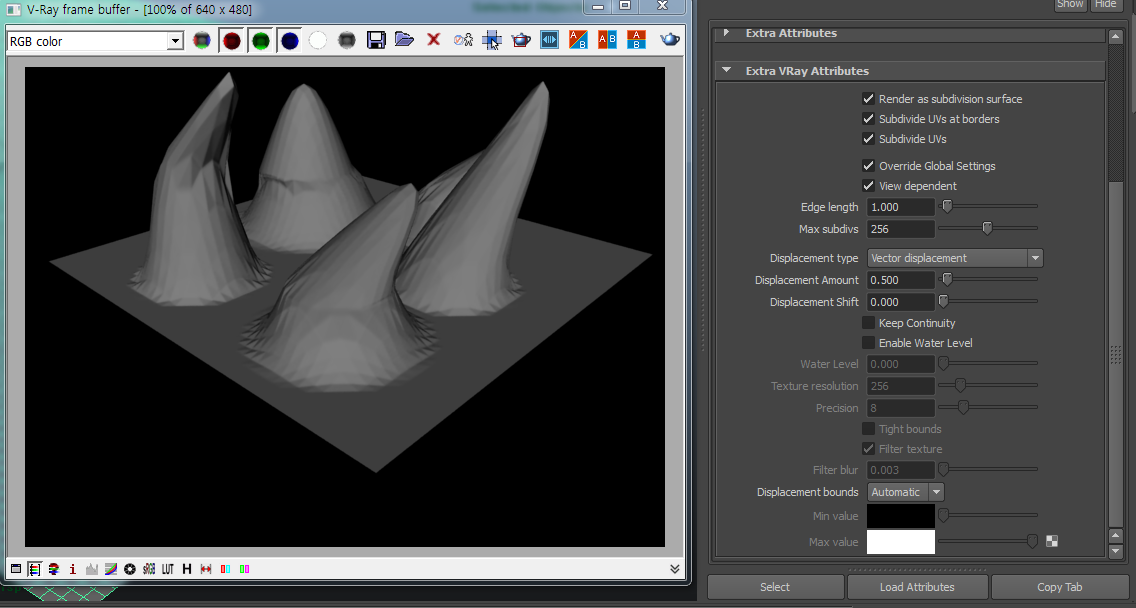

    I just tryed to use same image in V-Ray for Maya. Please check below image. I just changed the mode to vector displacement.
    It looks better than V-Ray for 3ds Max.

    I have no idea what I am doing wrong for this.
    Could you give me a hint to make a image for vector displacement and use it?

    Have you tried using a regular 3ds Max Bitmap texture, just in case?
    Vlado
      Vlado
      vectorDisMap.zip
      Yes. But there was same problem with 3ds Max Bitmap texture.
      I just attach the Vector dis Map if you don't mind please try to test it.
      Best Regards,
      Sangho Jung.

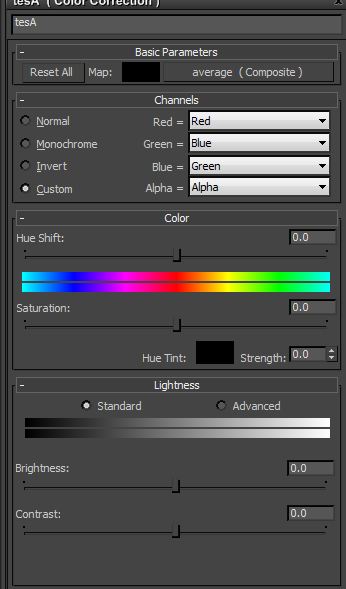

        Here is a short tutorial on rendering vector displacement from Mudbox with V-Ray for Maya; in 3ds Max, since we don't yet have the absolute vector displacement mode, you'll have to multiply the texture by RGB 0.5, 0.5, 1.0 and add to it RGB 0.5, 0.5, 0.0. You may also have to switch the green and blue components.

                  I've made this "RGB 0.5, 0.5, 1.0 and add to it RGB 0.5, 0.5, 0." equation by vraycombtex and checker with specific color.
                  I don't know how to switch channels.
                  I tried many combinations with vrayhdri, bitmam and vraydisplacementmod but I am still getting this errors.
                  What I am doing wrong? channel switch?

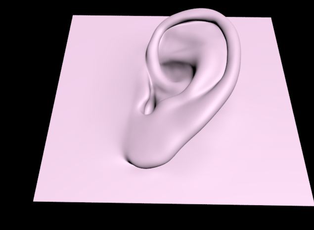

                    Eureka!

                    Found it from that scene uploaded by someone nicknamed Alvarezcb:
                    http://dl.dropbox.com/u/11943709/Mud...splacement.zip
                    I used the ear vector displacement supplied by Beige on another thread here:
                    http://www.can-con.ca/temps/ear_tan_vdm.exr.zip

                      I think it just don't work and hope it would be fixed in some service pack.
                      gomo.pl
                        If you look again at my precedent post you will see it works. You just have to output your vector displacement to look the same as the ear vector map I supplied the link to.

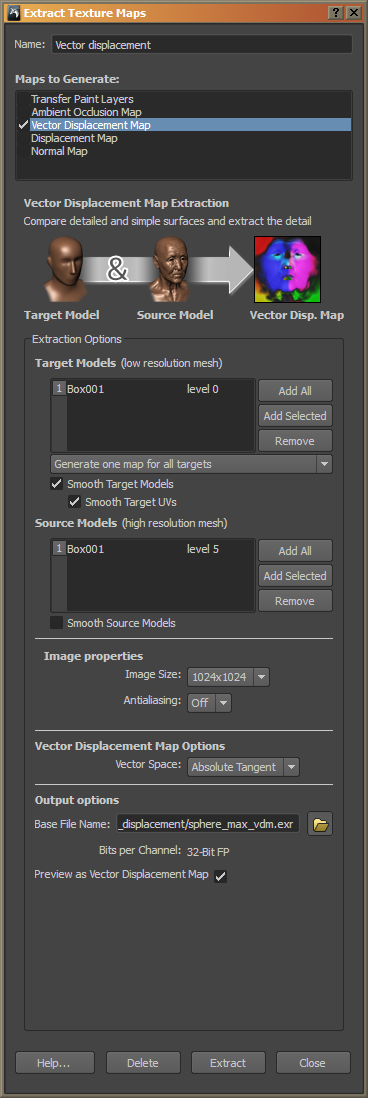

                        Or try those settings in mudbox:
