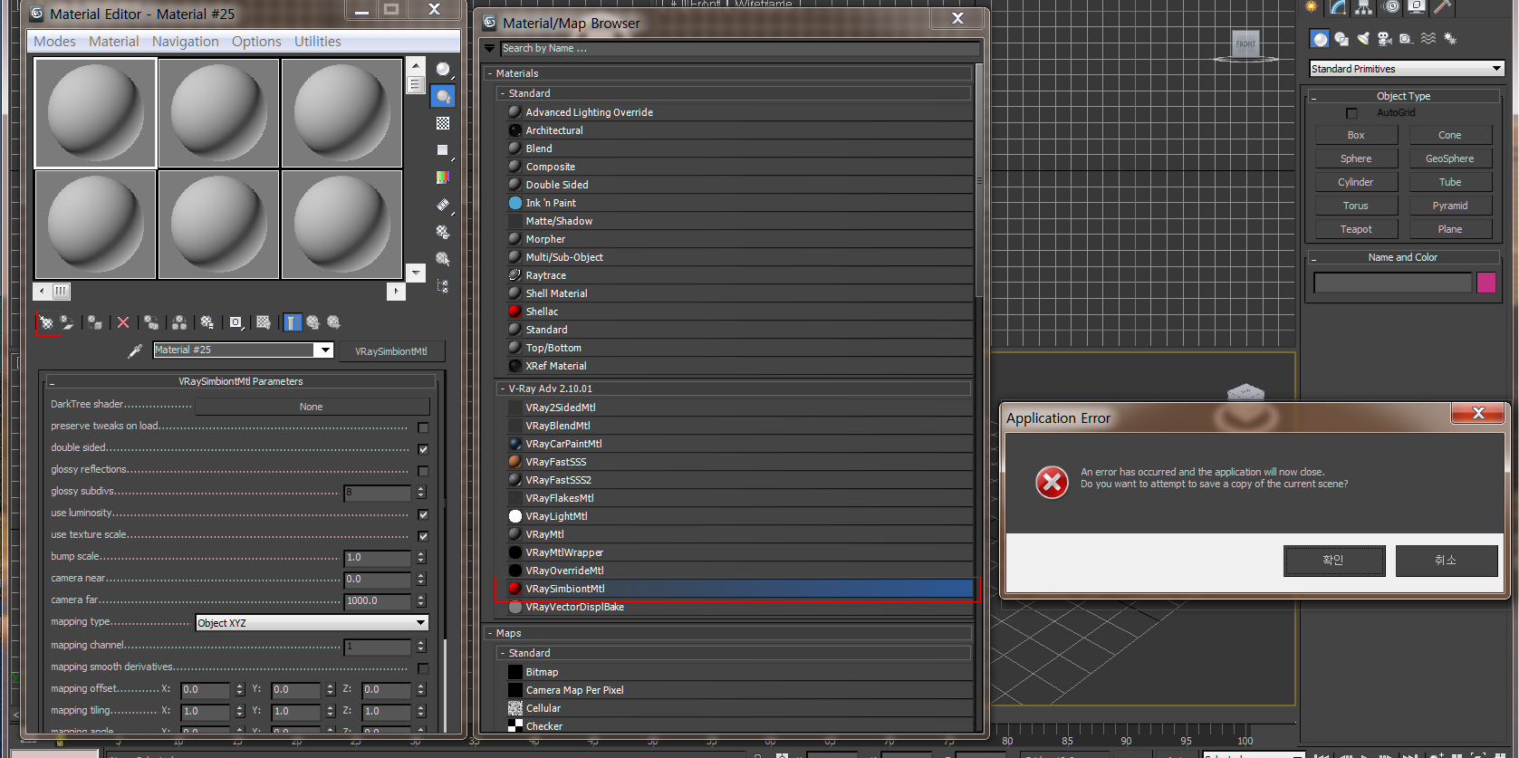

    Dear Chaos Group Support Team,
    When I try to make VRaysimbiontMtl(V-Ray 2.0 SP1) on 3ds Max 2012, the 3ds Max crash everytime.
    Please check below image to know what happend.

    We have reproduced the issue. It's reported to our developers and we'll post back when it's fixed.
    In the meantime try to use the Slate Material Editor instead of the Standard one. You should be able to use VRaySimbiontMtl without this causing 3ds Max to crash.

      Thank you for your kindness.
      Yeap, it is working great with the State Material Editor.
