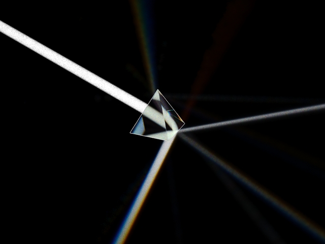

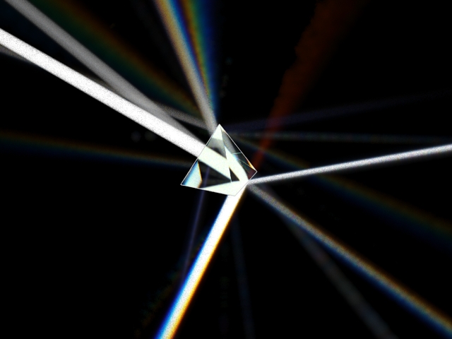

      My results seem to have far more beams and various things going on that what you see in the YouTube vid. I thought i would get one beam of light and then out the other end a rainbow of colour. I have posted some results below. I have taken notes from other threads on this forum.
      Both atmosphere shadows and optimized atmostpheric evaluation on

      Both atmosphere shadows and optimized atmostpheric evaluation off
      atmosphere shadows on only
      optimized atmostpheric evaluation on only
