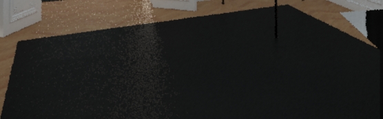

    I'm facing a strange issue with VRay light material reflections on other objects.
    As long as Direct Illumination is on, with Cut Off 0.001, reflection is cut ... putting it to 0.0 solves the problem, but render time obviously increases. Setting Direct Illumination off solves the problem as well, but I need to keep it on, so it's not a solution ! Am I missing something ?
    Any advice would be greatly appreciated
    Thanks in advance.
    Regards.
ID:	873520Click image for larger version

      It is somewhat normal; the only way to solve it for the time being is to reduce the cutoff.
