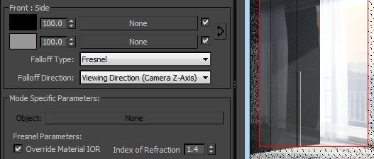

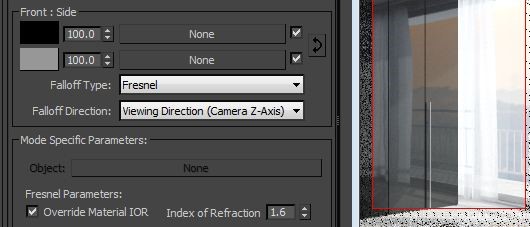

    there's a plane with a VrayLightMap for the background.
    with fresnel 1.6 the background is visible, but with a IOR of 1.4 it seems a cutoff happens... I can't get rid of it. is this a bug, or is it "right", but why?

    What is the cutoff threshold of the window glass?
    Vlado
      I have put it to 0.0
      I have no clue what's going on. as you can see there's a little corner where the background is visible (image IOR 1.4) it looks like something is cover the backgroundplane.

        Hm, then I don't have an immediate idea of what may be wrong; it would be best if you can get me that part of the scene to vlado@chaosgroup.com so that I can take a look.
